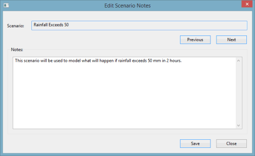

Edit Scenario Notes Dialog
This dialog is displayed when you click Edit Notes on the Manage Scenarios dialog. It is used to add or edit any notes which have been made about the scenario.
Show me
Dialog description
Item
Description
Scenario
A read-only field which contains the name of the current scenario whose notes are displayed in the Notes pane.
Previous
Displays the notes for the scenario before the current scenario in the Manage Scenarios dialog list.
Next
Displays the notes for the scenario after the current scenario in the Manage Scenarios dialog list.
Notes
The notes for the current scenario which can be edited as required.
Save Saves any changes to the notes without closing the dialog.
Close Closes the dialog. Any changes to unsaved notes will be discarded.
