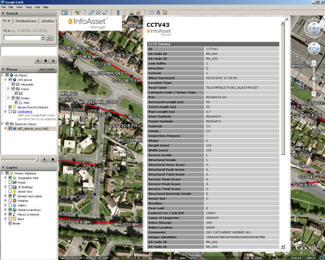

The Nodes are all clickable to reveal a balloon popup table of the node data. Each link has a smaller dot icon half way along, this can be clicked on to bring similar information for a link.
CCTV surveys are shown as lines, these will usually be over the top of links in the network. Point defects appear as crosses and continuous defects appear as 2 lines either side of the survey line with a smaller cross at each end. The colours should match those selected in the GeoPlan.
