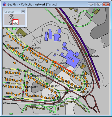

Figure 1 shows the area of interest.
  • Soil types are contained in a GIS Layer and shown in different shades of grey.
  • Roads, river channels, and buildings are contained in a different GIS Layer and show up using various colours
  • The underlying pipe network is not easy to see in this example, but this doesn't matter
The various roads and buildings of interest are described in the stages below.

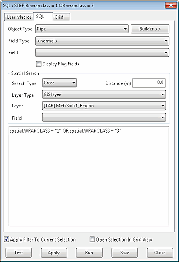

The second SQL object refines the selection made by the first SQL object. Note that Apply Filter to Current Selection is checked. This limits the network objects to which the SQL is applied to those already selected. This is a powerful feature.
  • This query tests the selected objects against data in a different GIS layer. This layer represents soil types, shown in Figure 1 as areas with different shades of grey.
  • the field WRAPCLASS contains the soil type information. WRAP stands for Winter Rain Acceptance Potential
  • in this case we are looking for difficult soil types, such as rocky or potentially waterlogged soils, where special equipment may be required to dig down to the pipe

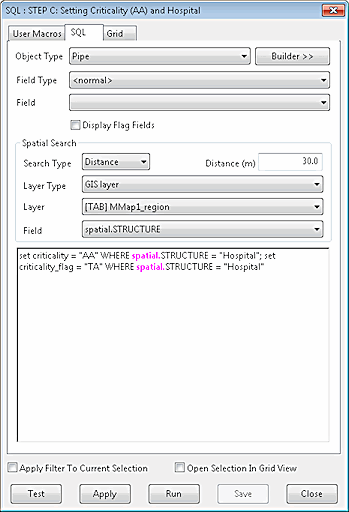

Next, we test our selected pipes to see if any of them is near a hospital. A pipe collapse near a hospital that blocked access or released wastewater in the area would probably be a major problem, and therefore repairing damaged pipes in this sort of situation will be more critical than elsewhere.
  • we are selecting any pipe that is within a certain distance of a hospital building
  • here we go one step further and actually set a data field and flag in the object so it can be easily identified in future. The Criticality field is set to AA (representing the highest value). We have also set the Criticality field flag. This could be a code for the method used to set the field, or even the initials of the person who ran the SQL.
  • in Figure 1 the hospital buildings are shown in pale blue. Just one pipe meets all the conditions we have set in our series of SQL statements. That pipe is highlighted in red.
