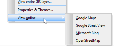

  3. Click on the location/ object of interest on the GeoPlan, and select View online from the context menu, then choose the desired map service.
    Tip:
    If several objects are selected on the GeoPlan, only the GPS coordinates of the last object will be used by the online mapping service.
    Online map availability on the GeoPlan context menu is configured in the Online Map Options dialog. Supported types include:
    • Google™Maps
    • Google™ Street View
    • Microsoft™ Bing
    • OpenStreetMap
    • User-defined URL

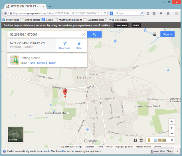

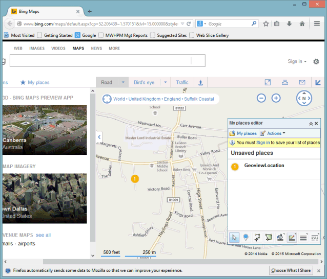

  4. The selected web mapping software is launched using the default browser and opens the map with the location / object corresponding to the GPS coordinates that have been clicked on the GeoPlan highlighted on the map. By default, the map will be centred on these coordinates:
GoogleMaps example
GoogleMaps
Microsoft Bing example
Microsoft Bing
