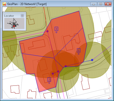

Creating rain gauge boundaries using Thiessen Polygons
Rain gauge boundaries can be created automatically in InfoWorks ICM using the Thiessen Polygon method.
InfoWorks networks
- Create a new polygon to act as a bounding polygon within which the rain gauge boundaries are to be defined.
- Define rain gauge locations by:
- Selecting Rain gauge data
Import from map data from the GeoPlan menu to import rain gauges from GIS.
- Creating new rain gauges using the New Object
button and ensuring that the 'Rain gauge' option is selected in the New Object Type combo box on the GeoPlan Tools toolbar: Click on the location of the rain gauge in the GeoPlan view and type in a profile number for the rain gauge.
To 'move' a rain gauge; create a new rain gauge with the profile number of the rain gauge to be moved. The old point will be removed, and a new point will be created at the location clicked on in the GeoPlan view.
- Select Rain gauge data
Generate boundaries from the GeoPlan menu. Rain gauge boundaries will be generated using the Thiessen Polygon method.
- Save the rain gauge boundaries by associating the boundaries with a Rainfall Event. See below for details.
