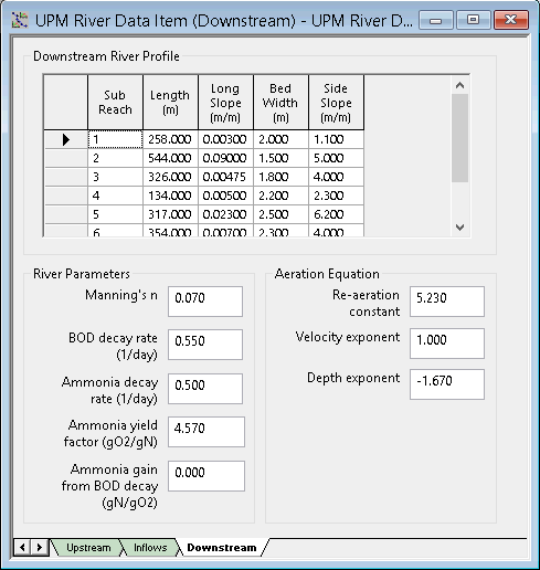

The Downstream tab on the UPM River Data dialog allows you to enter information relating to the river immediately downstream from the CSOs (combined sewer outfalls).
The UPM River Data dialog is displayed when you open an existing UPM river data item by either double-clicking on the item in the model database tree or by right-clicking on it and selecting Open from the context menu.
Downstream River Profile
The concentration of dissolved oxygen in the water is affected by the river profile. You should enter parameters for up to forty sub-reaches, representing the river profile downstream from the CSOs. Note that the cross-sectional profile of each sub-reach is assumed to be trapezoidal and symmetrical. Select sub-reaches to represent significant changes in the slope of the river bed or its width.
The following fields must be specified for each sub-reach:

River Parameters
For dissolved oxygen impact assessments, you must enter the following parameters relating to the river downstream from the CSOs:

Aeration Equation
Re-aeration of the water is calculated using the following equation:
where: K2 is the re-aeration factor, corrected for temperature Cs is the saturation concentration of DO at a given temperature DO is the initial dissolved oxygen in the river |
The re-aeration factor is calculated from:
where: v is the flow velocity d is the water depth a, b and c are constant The three constants used in the calculation of K2 must be entered as follows:
