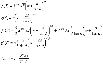

which can be solved for d using an appropriate non-linear equation solver. A Newton-Raphson method has been implemented in InfoWorks ICM.
Newton-Raphson requires the solution of the following equation:
where:
This has been implemented with a default depth estimate of 1.0 m for the first sub-reach. Subsequent sub-reaches use the depth from the previous sub-reach as the initial estimate.
With d known, A can be calculated and the velo,city, U simply equals Q/A.
