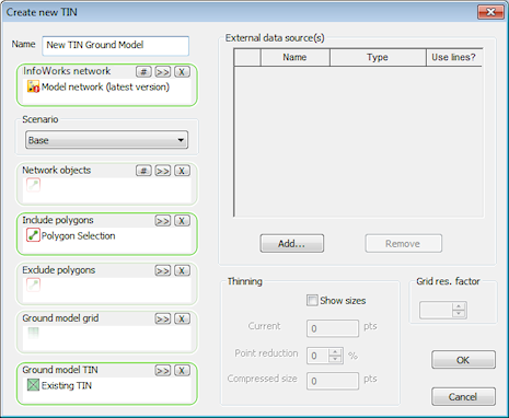

To create a TIN Ground Model from other data
- On the
Explorer Window, right-click a
Model
Group and choose
New
InfoWorks
Ground model TIN or New
SWMM
Ground model TIN
from the popup menu. This displays the
Create New TIN Ground Model dialog.
- Enter a name for the new TIN ground model in the Name field.
- Choose the data from which the ground model will be generated (see below for more details). If conflicting points are found in the data, the data points will be prioritised so that points from data types further up this list will overwrite points from any data type below them on the list.
- Network data (from cross section lines, bank lines, river reaches and general points)
- Existing ground models
- TIN ground model
- Grid ground model
- External data sources
- MapInfo MIF files
- ESRI Shape files
- LandXML XML files
- Text files
- Click Create TIN to start the creation process.

Creating a TIN from an existing ground model
A new TIN can be created from an existing TIN or grid ground model.
Parts of an existing ground model can be clipped and saved as a new TIN by using the Include polygons option on the Create New TIN Ground Model dialog.
- On the GeoPlan, draw a general polygon encompassing the part of the existing ground model to be saved as a new TIN.
- Save the polygon in a Selection List.
- On the
Create New TIN Ground Model dialog:
- Drag and drop the relevant
InfoWorks or
SWMM network into the
InfoWorks network or
SWMM network box, or use the
button to browse for a network.
- Drag and drop an existing TIN ground model into the Ground model TIN box, or an existing Gridded ground model into the Ground model grid box. Alternatively use the
button to browse for an existing ground model.
- Optionally, drag and drop a
Selection List containing general polygons into the Include polygons field or use the
button to browse for a Selection List.
InfoWorks or
- Click OK to start the creation process.
The newly created TIN will be created using only the section of the ground model within the selected polygon.

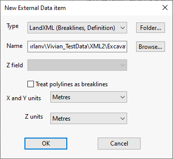

Create a TIN from an external data source
To create a TIN from a MapInfo MIF file, ESRI Shape file, LandXML XML file or text file
- Click Add on the
dialog, and the
New External Data Item dialog is displayed.
- Select the type of file containing data from which the ground model will be generated and Browsefor the file to be used. The path will be displayed in the Name field.
- LandXML (Breaklines, Definition): contains x, y, z lines.
- LandXML (Datapoints, Contours): contains x, y, z points. Note that the Treat polylines as breaklines box must be checked to enforce the polylines as TIN edges
- MIF file (points): contains x, y points. Select the field in the table containing z values from the Z field dropdown list.
- Shapefile (points): contains x, y points. Select the field in the table containing z values from the Z field dropdown list.
- Shapefile (pointZ): contains x, y, z points.
- Shapefile (polylineZ): contains x, y, z polylines. The points that make up the polylines will be used to create the TIN. Check the Treat polylines as breaklines box to enforce the polylines as TIN edges.
Text (X Y Z spot heights): contains points data used to create the TIN. The file format is three values per line defining each point (x y z). The values are separated by a TAB or a SPACE and the encoding of the file is UTF-8 or ANSI. A point (.) should be used as the decimal separator. An example of text in this type of file is shown below:
103245.5256 194091.8938 9.9019
103270.5256 194091.8938 9.497
103295.5256 194091.8938 9.4638
103320.5256 194091.8938 9.6057
103245.5256 194066.8938 9.8897
103270.5256 194066.8938 9.3361
Text (X Y Z polylineZ): format is similar to the Text (X Y Z spot heights) file, except the file includes the text ENDLINE, which defines the end of each polyline. Each line must be defined by at least 2 points. An example of text in this type of file is shown below:
100245.5256 191091.8938 9.9019
100270.5256 191091.8938 9.497
ENDLINE
100545.5256 190991.8938 9.9662
100295.5256 190966.8938 9.6603
100320.5256 190966.8938 9.1558
ENDLINE
- If you browsed for LandXML (Breaklines, Definition) or LandXML (Datapoints, Contours) files, a
LandXML Surface dialog is displayed. In this dialog:
- If you want to specify the units to be used by the ground model, click on the Editing units setting button to display the LandXML Units dialog. Specify the units and then select OK.
- Select which LandXML surfaces you want to include in the ground model from the ones displayed in the tree structure.
- Click OK.
- Select X, Y and Z units from the dropdowns.
- Click OK to return to the Create New TIN Ground Model dialog.
