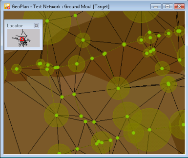

The outlines of the underlying triangles that make up a TIN ground model can be displayed on the GeoPlan Window.
TIN Triangles Displayed on the GeoPlan
Note: The underlying triangles are only displayed if the TIN ground levels are displayed as a theme.Only display TIN triangles when needed. With triangles displayed the performance of the GeoPlan Window will be affected.
To display TIN triangles
- Display the ground model as a theme if it is not already displayed.
- Right-click on the GeoPlan Window and choose Properties & Themes from the popup menu. This displays the GeoPlan Properties dialog. This dialog may already be open if setting the parameters to display the ground model as a theme at the same time.
- Switch to the Visual page.
- Check Show Triangles in TIN Ground Models to display the triangles.
