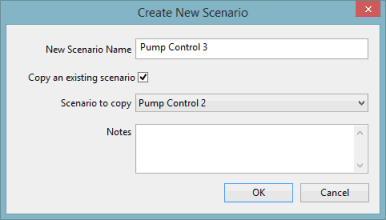

- Click the Create... button and the Create New Scenario dialog is displayed.
- Name the new scenario 'Pump Control 3'.
- Check the option and choose 'Pump Control 2' from the Scenario to copy drop-down list.
- Click OK.
The Create New Scenario dialog closes and the new scenario is added to the list of scenarios in the Manage Scenarios dialog.

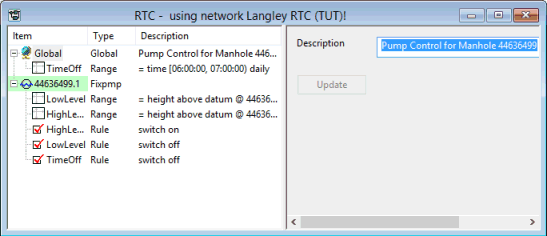

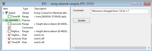

- Open the
RTC Editor. Select the Grid windows
RTC Editor option from the Window menu.
The RTC Editor is displayed.
- Change the level at which the pump switches on:
- Click the
(Expand) buttons to the left of the 'Global' and 'Fixpmp' terms to display their dependents and adjust the column widths if necessary.

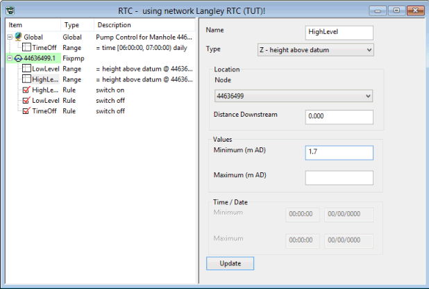

- Click the 'HighLevel' Range so that the details are displayed on the pane on the right.
- Change the Minimum value to '1.7'.
- Click Update.
- Click the
- Add a comment to remind you of the change that has been made:
- Right-click the 'HighLevel' item and select Insert Definition
Comment from the pop-up menu.
- Type an appropriate comment in the right pane.
- Click the Update button. The comment is included in the list on the left pane.

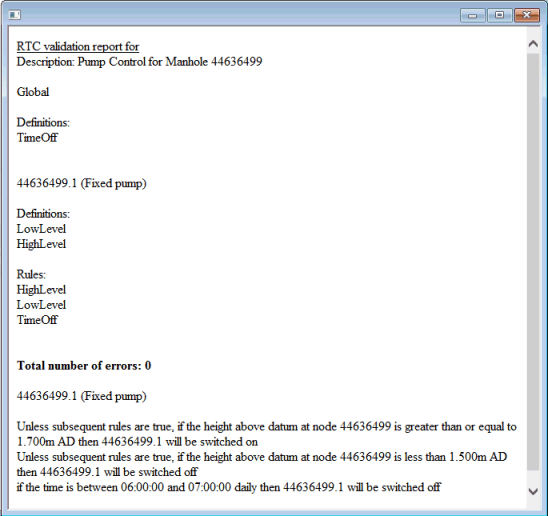

- Validate the scenario:
- Right-click any item in left pane the
RTC Editor and select Full validation from the pop-up menu.
The validation process checks for errors in logic and displays a full description of the rules in the scenario.
- Close the 'RTC Validation Report' text window.

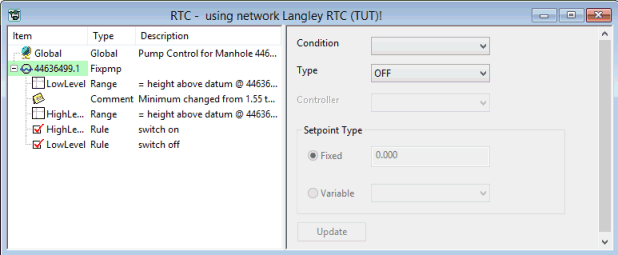

- Delete the 'TimeOff' range and rule:
- Right-click the 'TimeOff' range (below 'Global') and select Remove Dependent from the pop-up menu.
- Right-click the 'TimeOff' rule (at the bottom of the 'Fixpmp' list) and select Remove Dependent from the pop-up menu.

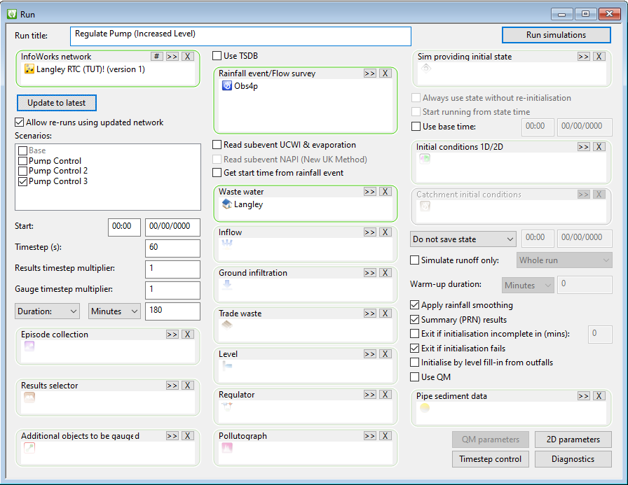

- Run the simulation with the revised scenario:
- Open the 'Regulate Pump' run. Right-click the 'Regulate Pump'' run and select Open from the pop-up menu.
The Schedule Hydraulic Run dialog is displayed.
- In the Run title field, change the title to 'Regulate Pump (Increased Level)'.
- Click the Update to Latest button. The list of scenarios associated with the network in the Scenarios field is also updated when this button is selected.
- Check the Allow re-runs using updated network box.
- Check the box next to the Pump Control 3 option in the Scenarios field.
- Click Run simulations.
If this is an on-premise Run, a Schedule Job(s) dialog is displayed.
- Click OK.
InfoWorks ICM processes the run and its progress can be viewed in the Job Control window. This window can be displayed by selecting the Job control window option from the Window menu.

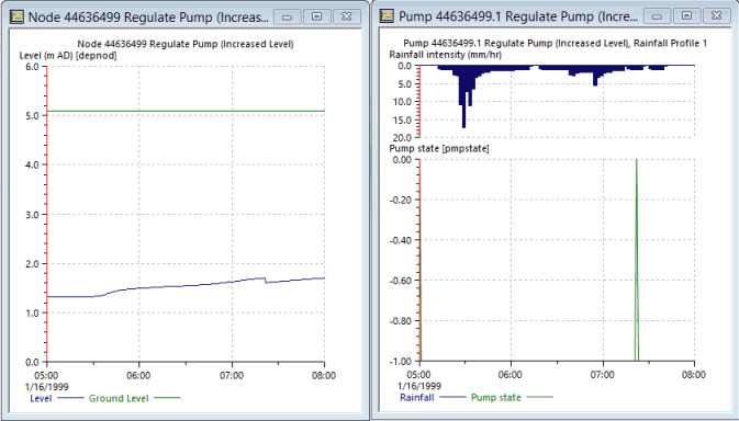

- Use the
(Graph pick) button to display graphs of Level for '44636499' and Pump State for '44636499.1'. Click node '44636499, choose 'Level' from the list and click OK to display the graph. In a similar way, click the link, choose 'Pump State' and then click OK.
- Arrange the views horizontally. The results show that the level now takes much longer to reach the switch-on value. As a result, the pump is not switched on until much later in the simulation.
