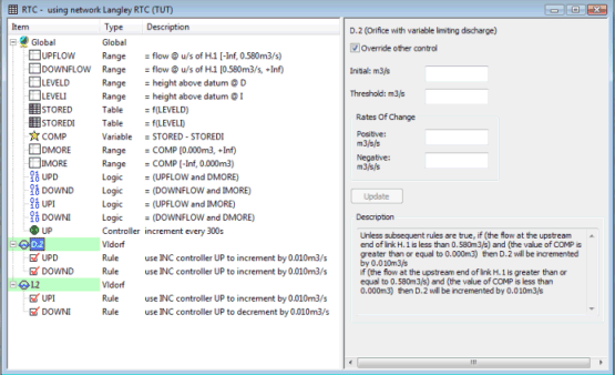

The left-hand pane of the window gives a representation of an RTC object; the right-hand pane varies depending on which element of the RTC object has been selected.
A scenario contains one or more regulators. Under each regulator, the following components can be added:
Components can also be inserted under the Global object. These components can be used by any of the regulators in the scenario.

- To add a title to the RTC , click on the Global record at the top of the left-hand pane of the RTC Window Editor. Enter a title in the Description Pane that appears in the right-hand pane of the Window.
- To show the items associated with a regulator, click on the
box to the left of the regulator name; to hide the items, click on the
box.
- To edit the definition of an item, click on the item and then edit the details in the right-hand pane. See the following for detailed information:
