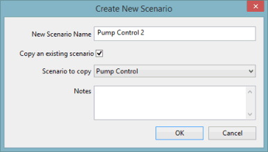

  3. Click the Create button and the Create New Scenario dialog is displayed.
    1. Name the new scenario 'Pump Control 2'
    2. Check the Copy an existing scenario box
    3. Select 'Pump Control' from the Scenario to copy drop-down list.
    4. Click OK.
      Create New Scenario based on Existing
  4. The Create New Scenario dialog closes and the new scenario is added to the list of scenarios in the Manage Scenarios dialog.

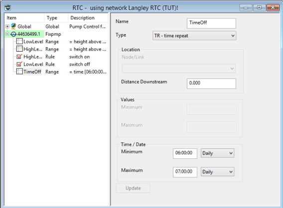

    4. Add a global range (which can be used by any regulator):
      1. Right-click the 'Global item' and select Insert dependent Range from the pop-up menu.
      2. Enter a Name of 'TimeOff' and select the 'TR - time repeat' option from the Type drop-down list.
      3. Enter '06:00:00' as the Minimum and '07:00:00' as the Maximum Time/Date. In each case, select 'Daily' from the drop-down list. This range will be applied each day that the simulation is run.
      4. Click the Update button.
      5. RTC Editor Pump Time Off
    5. The entry on the left is updated with the new details.

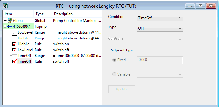

  7. Add the new rule for the regulator:
    1. Right-click the pump item and select Insert dependent Rule from the pop-up menu.
    2. For the Condition, select 'TimeOff' from the drop-down list.
    3. For the Type, select 'OFF' from the drop-down list. This rule specifies that when the 'TimeOff' condition is satisfied, the regulator is switched off. The 'TimeOff' condition is satisfied when the time is between 6 A.M. and 7 A.M.
      RTC Editor Pump Time Off Rule

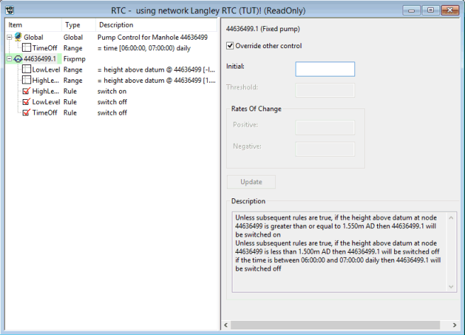

  8. Inspect the scenario:
    1. Click any item in the list to view or edit its definition.
    2. Click the regulator to specify whether the rules override any controls in the network and to give it an initial value. The full description of the regulator is shown in the box at the bottom of the right-hand pane.

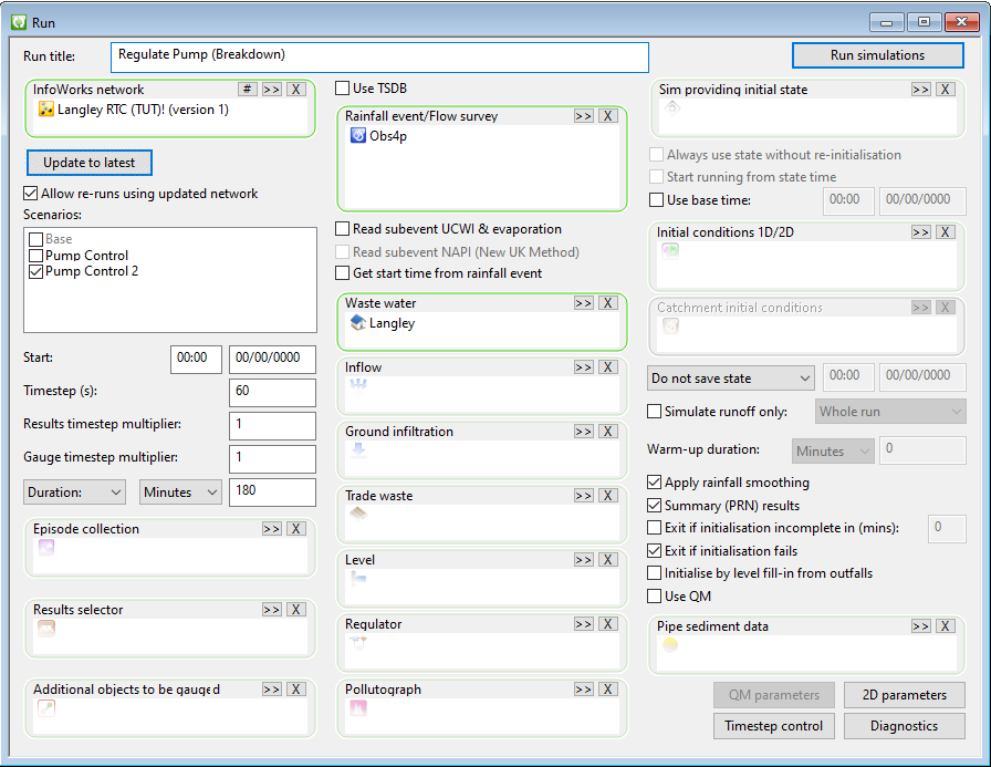

  10. Run the simulation with the revised scenario:
    1. Open the 'Regulate Pump' run. In the Explorer window, locate the 'Run Group' in the RTC Model Group, right-click the Regulate Pump’ run and select Open from the pop-up menu.
      The Schedule Hydraulic Run dialog is displayed.
    2. In the Run title field, change the title to 'Regulate Pump (Breakdown)'.
    3. Click the Update to Latest button. The list of scenarios associated with the network in the Scenario field may also be updated when this button is selected.
    4. Check the Allow re-runs using updated network box.
    5. Check the box next to the Pump Control 2 option in the Scenarios field.
      The settings for all other options remain unchanged.
    6. Click Run simulations.
      If this is an on-premise Run, a Schedule Job(s) dialog is displayed.
    7. Click OK.
      InfoWorks ICM processes the run and its progress can be viewed in the Job Control window. This window can be displayed by selecting the Job control window option from the Window menu.

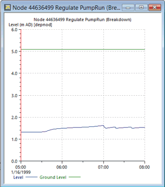

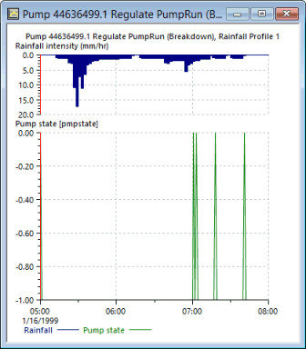

    2. Use the (Graph pick) button to display graphs of Level for 44636499 and Pump State for 44636499.1.
    3. Zoom in on the pump region. You can, for example, use the Find in GeoPlan option in the GeoPlan menu or click the (Find in GeoPlan) tool, to zoom onto the manhole that contains the pump. In the dialog, enter the node id, in this case, 44636499, and click the Find button, and the GeoPlan will be centred on the specified manhole.
    4. Use the button to display graphs of Level for '44636499' and Pump State for '44636499.1'. Click node '44636499, choose 'Level' from the list and click OK to display the graph. In a similar way, click the link, and choose 'Pump State' and then click OK.
    5. Arrange the views horizontally. The pump now stays off until 7 A.M. After that point, it is switched on whenever the level exceeds 1.55 mAD, as before. The level in manhole 44636499 now reaches a much higher value before the pump is switched on for the first time.
    6. RTC Simulation Results Pump 2 Level Graph RTC Simulation Results Pump2 State Graph
