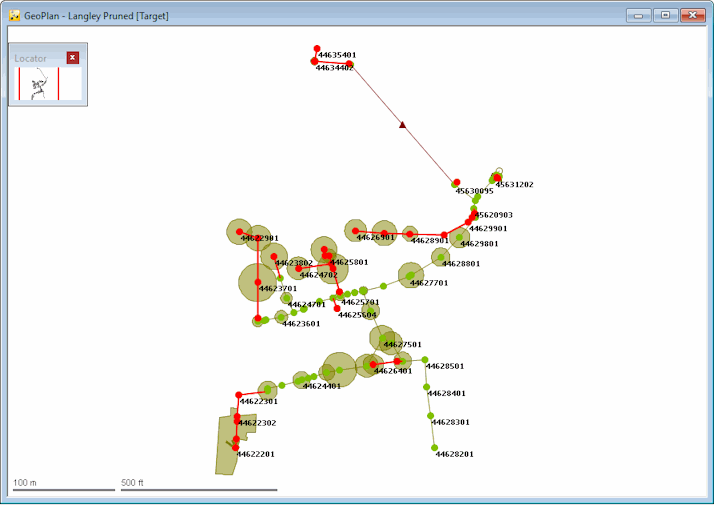

- Open the 'Langley Pruned' network. Either right-click the network in the Explorer window and select Open from the pop-up menu, or drag the network icon into the InfoWorks ICM main window.
- Drag the 'Pipes < 250 mm' selection list (which was created in the
Creating Selection Lists with SQL topic and is located in the 'Selection List Group' in the
Explorer window) onto the network. This are the links that may be pruned (removing them would not significantly affect the network).
- Set up the pruning options:
- From the Model menu, choose the Simplify
Simplification options option. The
Simplification Options dialog is displayed.
- Click the Network Simplification tab.

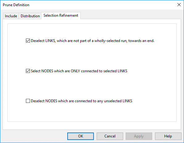

- In the Prune pane, click the Define button. The Prune dialog is displayed.
- Click the Selection Refinement tab.
- Make the following refinements:

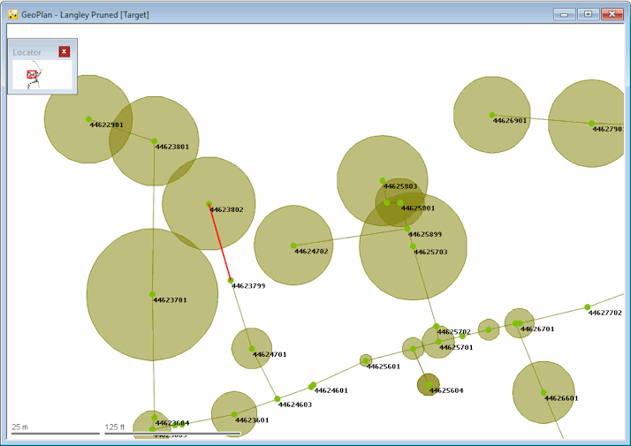

- Check the Deselect LINKS, which are not part of a wholly-selected run, towards an end. box. This will remove from the selection any links whose deletion would leave other links "stranded" (for example, link '44624602.1', which has a width of 225 mm but is downstream of a run of wider pipes).
- Check the Select NODES which are ONLY connected to selected LINKS box. This will include any nodes that are connected only to selected links and would therefore end up not connected to the network (for example, node '44623802' is connected to only a single selected link but node '44623799' will still be connected to a link after pruning).
Show me
- Do not check the Deselect NODES which are connected to any unselected LINKS box. This option removes from the selection any nodes connected to unselected links. This function is not required in this case as no nodes were included in the 'Pipes < 250 mm' selection list opened in Step 2.
- Click the OK button on both windows.

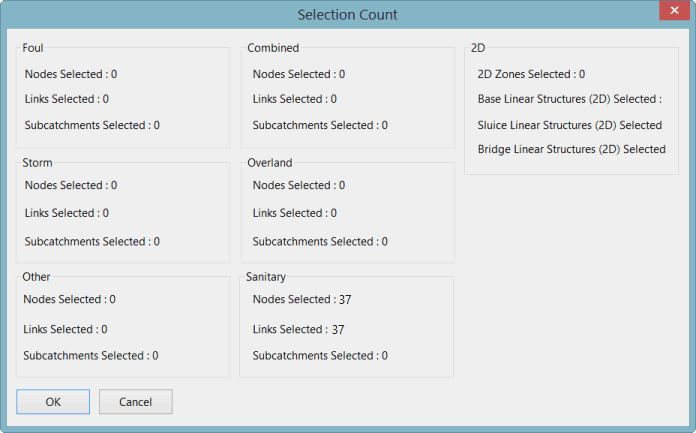

Count selected objects option from the Selection menu to check the effect of the pruning. A
Selection Count dialog is displayed informing you of the number of objects that will be affected by pruning.
If you are using the tutorial network, then the message should show that 6 of the original 41 links have been deselected (leaving 35) and 35 nodes have been added to the selection. If you are using another network, then the count will depend on the network you are using.

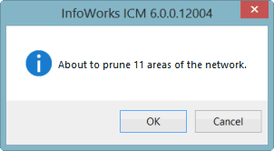

- Select the Simplify
Prune selection option from the Model menu. A message is displayed informing you of the number 'areas' to be pruned.
An 'area' in this context is a connected set of links and nodes.
The count depends on which network you are using. If you are using the tutorial network, then 11 areas are to be pruned.
- Click OK to prune the network.

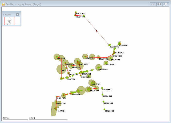

The pruned objects are still held in the database and can be
restored later by clicking a pruned link and then on the Restore button in the Pruned Objects Properties dialog .

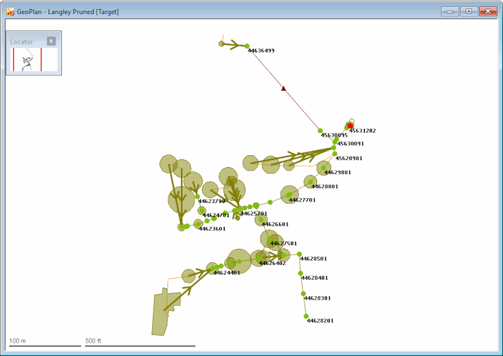

The remaining areas are pruned, with the removed links shown as orange lines.

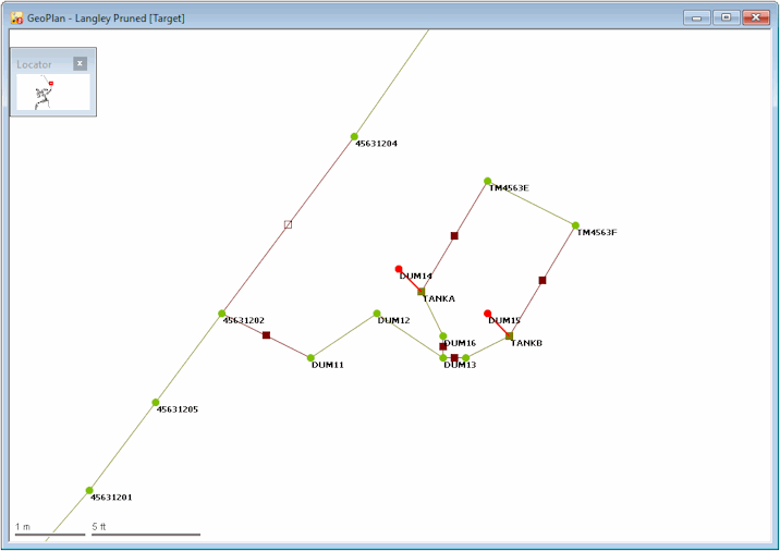

- Right-click the GeoPlan and select the Zoom to selection option from the pop-up menu to zoom in on the unpruned links. These are the two dummy links leading to the storage tanks. Links connected to storage nodes cannot be pruned.

- Two links near the storage tanks could not be pruned.

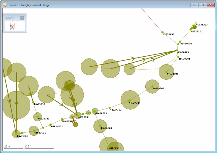

- The link below the pump has not been pruned because the pump has not been selected. The pump (which now pumps from nowhere) should also be pruned.

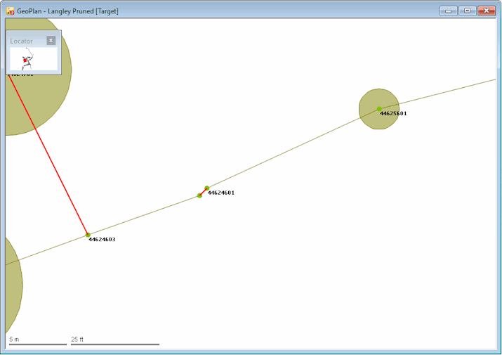

- The remaining pipes look as if they should have been pruned. Move the pointer over them and double-click the supposedly pruned link that goes northward to '44625704'. There is another link that is duplicated and was not pruned.
- Use the
(Polygon select) tool to select the double links.

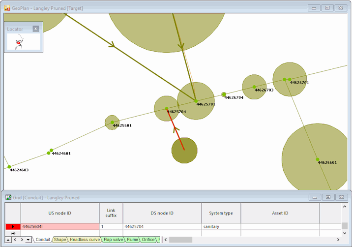

- Display the
Links grid.
Select the Grid windows
New grid window option from the Windows menu to display the grid containing the properties for all the links in the network.
- Move the entries for the selected links to the top of the grid so that they can be compared. You can see that the upstream node has been deleted, but the duplicate link 446256041.1 has not.
You can use the Group network selections at top of grid option in the Grid menu to move the entries for the selected link properties to the top of the grid.
- Click to the left of the '44625604!' record (which has a Link suffix of '1') so that it is the only one selected and press the DELETE key to delete it.

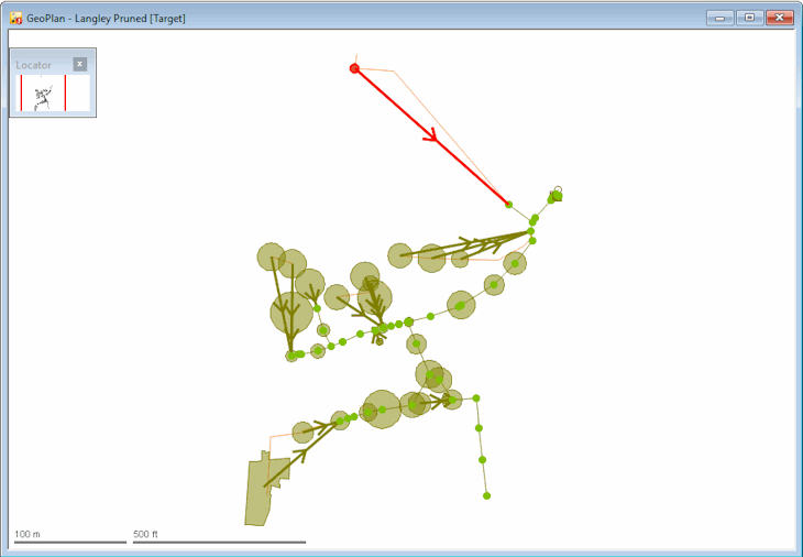

- Confirm the deletion of three areas by clicking OK in the message window. The two superfluous 'arms' are removed. As before, there are two links (into the storage tanks) that cannot be pruned.
- Check that there are only four links left in the 'Pipes < 250 mm' list. Selections lists are created independently of networks. Therefore, the same list applied to two different networks may yield different sets of objects if the objects in the networks are different. In this case, the 'Pipes < 250 mm' selection produces a smaller list for the pruned network; however, the list itself is unaffected and will still result in the full selection if re-applied to any of the earlier networks.

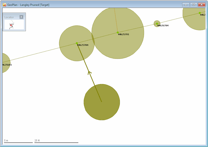

- Delete the subcatchment that drained to the node at the top of the pump:
You can restore the pruned objects, but you cannot restore deleted objects. If you think you might need to restore deleted objects, you should
export them to a CSV file
before you start to delete them.
- Select the
(Selection) tool and select the subcatchment to be deleted.
- Right-click the GeoPlan and select the Subcatchment
Delete option from the pop-up menu. A message is displayed informing you of the deletion.
