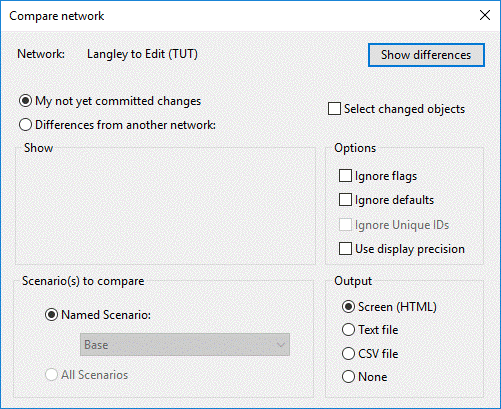

- Right-click the 'Langley to Edit (TUT)' network entry in the Explorer window.
- Select the Compare option from the pop-up menu. The
Comparison dialog is displayed showing the name of the current network at the top of the window.

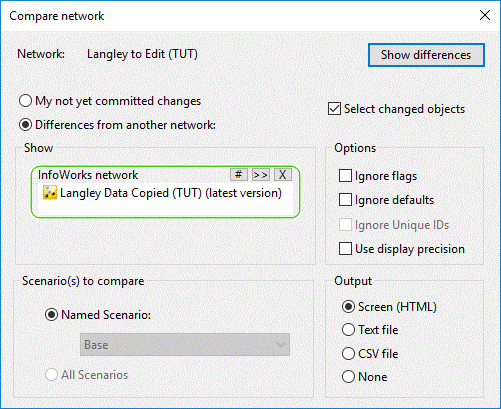

- Check the Differences from another network box to compare two different version controlled items. The Show pane is now enabled.
- Drag the 'Langley Data Copied (TUT)' network entry from the Explorer window into the Show box.
- Check the Select changed objects box.

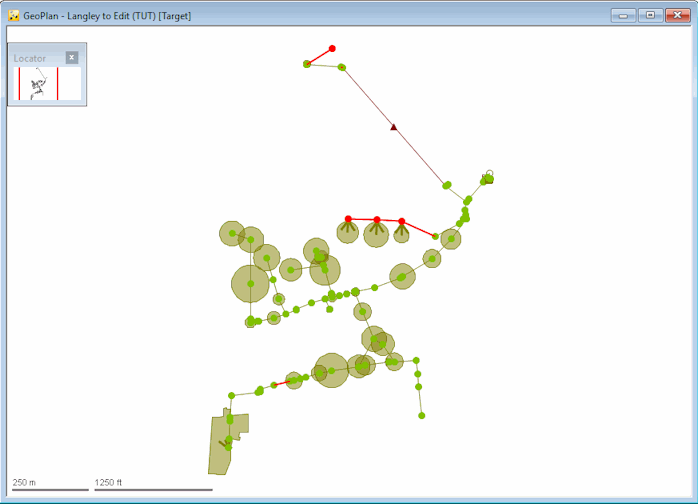

- Click Show differences. A Network differences text window is displayed listing the differences between the two networks and the changed objects are highlighted in the 'Langley to Edit (TUT)' network.
- Save the selected objects to a new 'All Edited Objects' selection list. Right-click the 'Langley to Edit (TUT)' network in the GeoPlan, and select the Selection
Save selection option from the pop-up menu. In the
Save As... dialog, click the Selection List Group and then on 'All Edited Objects', and finally click the
Save button.

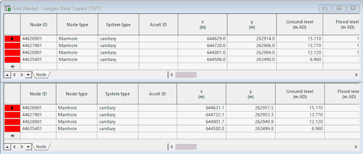

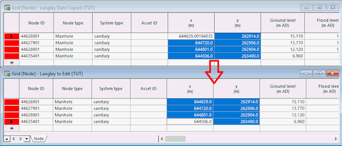

- Adjust the windows so that you can see both grids and use the Group network selections at top of grid option from the Grid menu so that the records for the selected nodes are at the top in both grids. Check that the Node IDs are in the same order.
- Change the column widths so that you can see the X and Y columns and freeze the Node ID columns. Some of the Y values and X values are different between networks for the selected nodes; the values that have changed (with the edited
data flag) are shaded pale yellow (as set in the
Editing Network Objects tutorial topic). See
Working with Grids and Property Sheets for information about manipulating the grids.

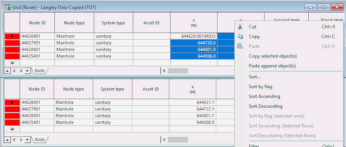

- On the 'Langley Data Copied (TUT)' node grid, select the X and Y column for the records with edited data flagged fields, right-click and select Copy from the pop-up menu.
- On the 'Langley to Edit (TUT)' node grid, right-click the top X value and select Paste. The block of data is copied across.

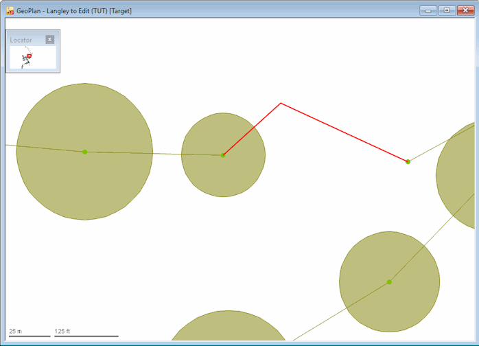

- Zoom in on link '44628901.1' on the 'Langley to Edit (TUT)' network (the link to which bends need to be added). You can, for example, use the Find in GeoPlan option in the GeoPlan menu or click the
(Find in GeoPlan) tool, to zoom onto the link. In the dialog, enter the link id, in this case, 44628901.1' and click the Find button, and the GeopPan will be centred on the specified link.
- Use the
(Select) tool to select only this link.
Right-click the GeoPlan and choose Zoom to selection from the pop-up menu.
