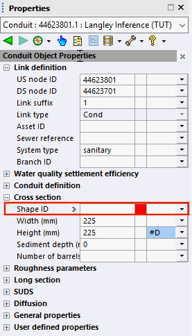

- Zoom in the zone in the north west area of the network and use the
(Properties) button to look at the properties of nodes 44623801, 44623701 and 44623604, as well as the related links (44623801.1 and 44623701.1). These objects have missing data; Ground levels for the nodes (in the Nodes location section of the
property sheet) and Shape ID for the conduits (in the Cross section section of the
property sheet).

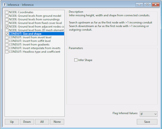

- Right-click the new 'Inference' object in the
Explorer window and select Open from the pop-up menu. The

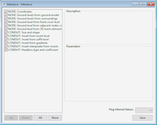

Inference dialog is displayed, which lists the inference rules that can be applied to the network on the left side of the window. By default, all the rules are selected.
The dialog shows that the process will infer node coordinates, node ground levels, pipe size and shape, invert levels and headloss data (in that order). You can change the order in which inference will be applied using the Up and Down buttons at the bottom of the dialog. Show me
- Click the None button to de-select all the rules.
- Click any of the rules to see any relevant parameters for that rule.
- For Flag Inferred Values, select IF from the drop-down list.
This ensures that any changed values are given a flag of 'IF'.
For the purpose of this tutorial, we are going to infer node ground levels from adjacent node covers and size and shape of conduits from connected conduits.
- Ensure that the NODE: Ground level from adjacent nodes covers and the CONDUIT: Shape and size are the only two check boxes selected.
- For the CONDUIT: Shape and size also ensure that you add a tick the Infer Shape box.
- Click Save to save the changes and then close the window.

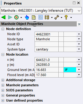

Either click the
- Use the
(Properties tool) to inspect the objects with inferred data. For example, display the
Property Sheet for node '43623701.
You can search for the node using the
(Find in GeoPlan) tool.
Fields with inferred data have an 'IF' data flag and are coloured as set up in Step 1. For the example bright blue was the selected colour.

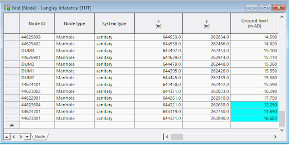

- Check the node data:
- Open the Nodes grid.
Click the
(New nodes window) button on the
Modelling Grid Windows toolbar to display the Nodes grid
- Sort the nodes by flag for the Ground Level column. Right-click a cell inside the Ground level column (not the column header) and select Sort by flag from the pop-up menu. Scroll down to the top or the bottom to see the nodes with the 'IF'' flag. Imported CSV values (#V flag) are shown in orange; inferred data (IF)) in our example is blue but yours may be different, user-defined edited data (ED in our case but your edited data flag may be different) is pale yellow), default values (#D) are blue; non-editable default values (also #D) are grey; entered data (with no data flag) is white; cells with missing required data are pink.

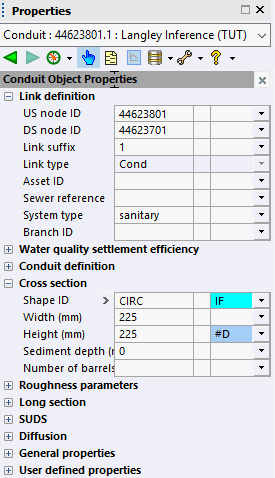

- Check the Conduit data. For example, open the Property Sheet for link '44623801.1' and go to the Cross section section.
In the following example, fields with inferred data have an IF data flag and are coloured bright blue.
