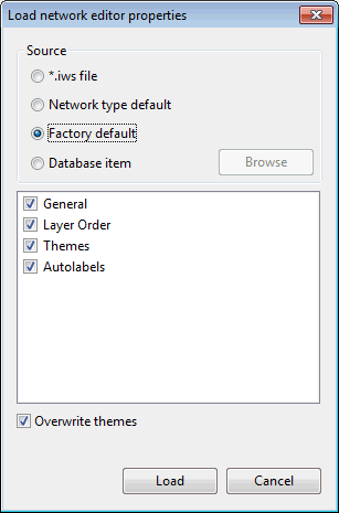

An example of the dialog when opened from the GeoPlan Properties dialog

Option |
Description |
*.iws file |
Loads an existing GeoPlan Properties file (IWS extension). Selecting this option and clicking Browse, displays a Windows standard Open dialog, allowing you to browse for the IWS file. Refer to the Network Editing Properties - Save Options dialog topic for details on how to export GeoPlan properties and themes to an iws file. |
Network type default |
Overwrites the current settings with the user default settings for the current network type. Refer to the Network Editing Properties - Save Options dialog topic for details on how to save current properties and themes as user defaults for all networks of the same type. |
Factory default |
Overwrites the current settings with the system settings. Clicking Yes on the subsequently displayed message confirms the overwrite. |
| Database item |
Loads an existing Themes database item. If selected, clicking Browse displays the Common Tree Selection dialog, where you can select the theme to be loaded from the tree and click OK to load the existing theme. (This option is disabled for Section properties and Grid layout properties.) |
| Properties and Themes box |
A context list that lets you choose which properties are to be saved. By default properties that have had changes to them are checked when the dialog is first opened. |
| Overwrite themes |
If checked, indicates that existing sub-themes will be overwritten with new ones. If unchecked, when themes are loaded they will not overwrite existing sub-themes of the same name in the same layer. |
