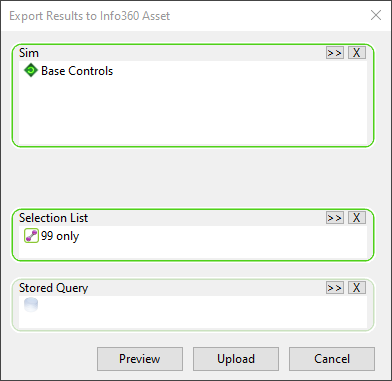

Export results to Info360 Asset dialog
This dialog is used to export results to Info360 Asset.
The dialog is displayed by selecting Export To Info360 Asset from the context menu of simulation results. See Exporting results to Info360 Asset.
Option Description
Sim[ulation]
For identifying one or more simulations to export.
  • You can drag one or more simulations into the box from the Explorer window or Model Group window.
  • You can drag a run into the box; all simulations in the run will be selected.
  • You can click the Browse (Browse) button to search for a simulation.
  • The (Delete selection) button can be used to delete items from the box.
Selection List
You can reduce the scope of the export.
  • You can drag a selection list into the box from the Explorer window or Model Group window.
  • You can click the Browse (Browse) button to search for a selection list.
If a selection is not chosen, the export will be carried out for the whole network.
Stored Query
You can add a stored query, if applicable.
  • You can drag a stored query into the box from the Explorer window or Model Group window.
  • You can click the Browse (Browse) button to search for a stored query.
Preview Opens your selection in a new preview window.
Upload Uploads your simulation results to your Info360 Asset tenant.
