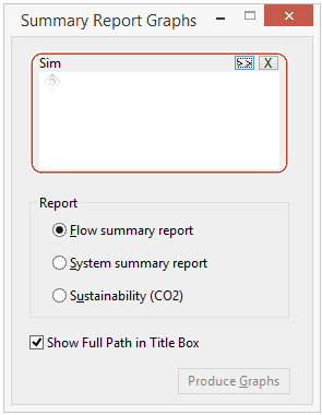

Summary Report Graphs dialog
This dialog is used to display a Flow, System or Sustainability Summary graph report.
Tip: See the Summary Report Graphs topic for details of the content of the reports.
The dialog is displayed by selecting Results | Graph reports | Flow & system summary report.
Item Description
Sim[ulation]
For identifying one or more simulations to base the report on.
  • You can drag one or more simulations into the box from the Explorer window or Model Group window.
  • You can click the Browse (Browse) button to search for a simulation.
  • The (Delete selection) button can be used to delete items from the box.
Report
The type of report to be produced.
  • Flow summary report - a set of graphs summarising the total flows in the system
  • System summary report - a set of graphs summarising the system demand balance
  • Sustainability (CO2) - a set of graphs summarising sustainability analysis of the system
Show Full Path in Title Box Displays the full path of the simulation object in the graph title box. If unchecked, displays the simulation name only.
Produce Graphs Generates the report.
