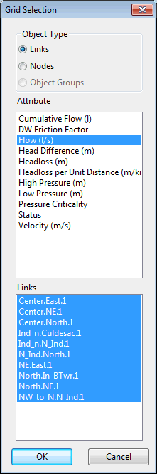

Grid Selection dialog
This dialog is used to display time varying results for a selection of network objects in the same grid.
See Grid results for selected objects for more on displaying time varying results data in a grid for more than one network object.
To display the dialog:
  1. Open a simulation for replay.
  2. Select one or more network objects.
  3. Click the (Grid selected objects) tool on the Operations toolbar, or select Selection | Grid results.
Object Type
The Links, Nodes and Object Groups radio buttons allow the choice of which type of object is to be included in the grid.
Attribute
Lists parameters that can be included in the grid in accordance with the selected object type.
If only one type of object is currently selected, the attribute list automatically contains the parameters for that type.
Only one attribute may be selected for inclusion in the grid.
Links
Lists the selected objects of the chosen object type.
If only one type of object is currently selected, the object list contains all selected objects.
(Selected customer points are included in the list when nodes are chosen as the object type.)
Within the list, the selection can be adjusted by clicking individual entries to deselect or reselect them.
Only the objects selected (highlighted) will be included in the results grid.
