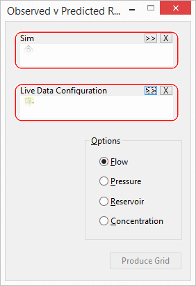

This dialog is used to set up a grid report of observed versus predicted results for a simulation.
The dialog is displayed when you choose Results Grid reports Observed v predicted.
Item Description
Sim[ulation]
For identifying one or more simulations to base the report on.
  • You can drag one or more simulations into the box from the Explorer window or Model Group window.
  • You can click the Browse (Browse) button to search for a simulation.
  • The (Delete selection) button can be used to delete items from the box.
Live Data Configuration
If live data is associated with the simulation in the current active window, the Live Data Configuration selection box will automatically be populated with the associated live data configuration. Alternatively, you can enter the live data configuration into the selection box.
If the merge method of version control is being used, the Version (Version) button appears when you add a live data configuration to the box. Clicking this button opens the Select Commit dialog, which you can use to select a different version of the object, if required.
Tip: Live Data Feed and Live Data Composite Feed can be used directly without having to create a Live Data Point first.
Options The attributes that will be included in the report.
Produce Grid Generates the report.
