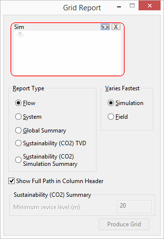

Grid Report (Time Varying) dialog
This dialog is used to set up a grid report of time varying results for one or more simulations.
The dialog is displayed when you select Results | Grid reports | Flow, system and global summary results.
Grid Report Dialog
Item Description
Sim[ulation]
For identifying one or more simulations to base the report on.
  • You can drag one or more simulations into the box from the Explorer window or Model Group window.
  • You can click the Browse (Browse) button to search for a simulation.
  • The (Delete selection) button can be used to delete items from the box.
Report Type
The type of report to be produced.
  • Flow - displays the Grid Report (Flow) View
  • System - displays the Grid Report (System) View
  • Global Summary - displays the Grid Report (Global) View
  • Sustainability (CO2) TVD - displays the Grid Report (Sustainability CO2 Summary) View
  • Sustainability (CO2) Simulation Summary - displays the Grid Report (Sustainability CO2 Summary) View
Varies Fastest
For a Flow or System report, if you have more than one simulation selected, this option changes the order of the columns:
  • Choose Simulation to have all the columns sorted by simulation.
  • Choose Field to have the columns sorted by field name.
Show Full Path in Column Header Displays the full path of the simulation object in the graph title box. If unchecked, displays the simulation name only.
Sustainability (CO2) Summary For a Sustainability report, the Minimum service level box is enabled. Potential energy loss at customer taps is calculated assuming this head is met at the node. The energy loss at minimum service level is compared with the loss calculated during the simulation to provide an evaluation of water efficiency.
Produce Grid Generates the report.
