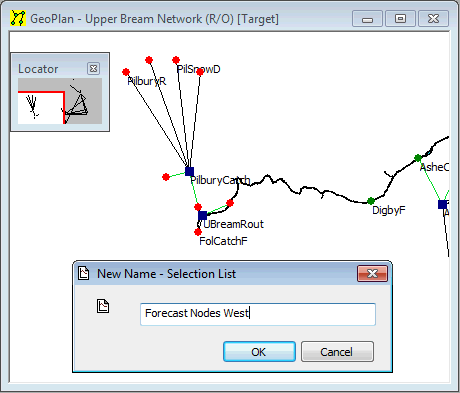

  1. A selection can be saved for future use:
    • Select one or more objects using the selection method of your choice. For example, click the Selection tool button, hold down Ctrl and click each of the objects in turn.
    • Right-click the Selection List Group in the Model Group window and select New | Selection list. If there is no Selection List Group, right-click the top icon and choose New | Selection list group.
    • Type an appropriate name for the selection (for example, 'Forecast Nodes West').
      Save selection
    • Click OK. There are a number of other ways of creating selections. See Selecting Objects for more information.
    • The selection list gets saved under the Selection List Group.
    • Click a blank area of the GeoPlan to clear the selection.
    • To select the same objects again, open the Selection List Group in the Model Group window (click the Plus button to the left of the group) and drag the selection list onto the GeoPlan.
    • Create a new selection list by repeating the steps above (selecting different objects on the network, for example), and save the list.
