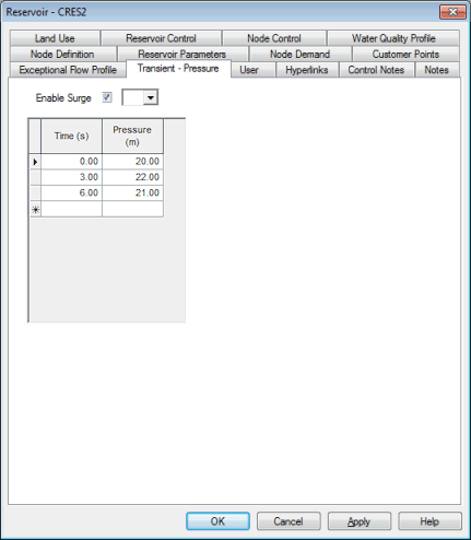

The Transient - Pressure page allows a pressure profile to be entered for use in Transient System Simulations. The fields on this page are stored in the Control Data.
Applies to Reservoir, Fixed Head and Well nodes. A change in pressure at the node will produce a transient. Time/Pressure pairs are specified to define the pressure variation.
Check the Enable Surge option to model a pressure profile at the node during a transient simulation.
The time entered in the profile grid is time relative to the start of the simulation.
