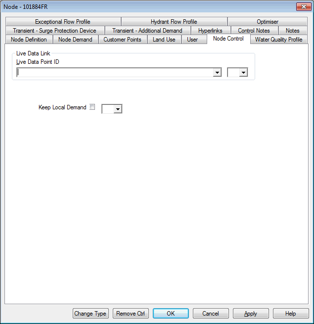

The Node Control Page allows you to view and edit control fields for nodes.
  • Live Data Point ID: Name of associated Live Data Point from Live Data Point, Live Data Feed, or Live Data Composite Feed. If there is a current Live Data Configuration, the drop-down list will contain a list of live data points.
  • Initial Age of Water: Used to specify age of water at start of simulation. Applicable to nodes at which water can enter the network i.e. Reservoir, Transfer, Fixed Head and Well.
  • Keep Local Demand: Check box to determine whether local demand (specified on the Node Demand Page, e.g. Customer Point demand) will be applied to the node in addition to any Exceptional Demand and Hydrant Flow.
