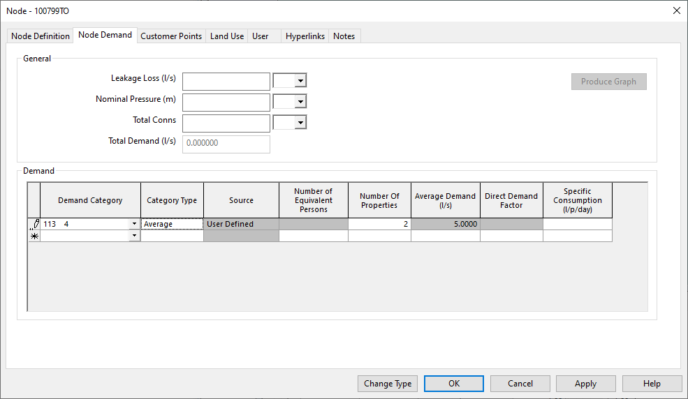

Node Demand parameters can be viewed and edited on the Node Demand Page.
This page can be used to set up demand at a node for specific demand categories. Graphs of demand at the node can also be drawn from this page.
It is possible to edit Node Demand parameters for all nodes using the Demand at Nodes Grid View. With the network open, click the button on the Window toolbar. However, the Node Demand Page is needed to draw graphs, or to use a Demand Category more than once for the same node.

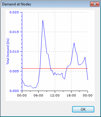

Graphing Demand
Select one or more Demand Categories in the grid (click the left hand cell of the row to select the row), and then use the Produce Graph button to display a graph of demand.
Note: There must be a Current Demand Diagram before demand can be graphed (with two exceptions - see Special Demand Category Cases below).
This graph is displayed using the Demand At Nodes dialog.
If more than one row is selected in the grid, the graph shows the sum of all selected demands.

Using the Node Demand grid
Select the Demand Category by typing into the field or selecting a category from the dropdown list. The list will only be filled when there is a Current Demand Diagram. The demand for each Demand Category is defined in one of three ways:
Demand per Property
Fill in the Specific Consumption and Number of Properties fields for the demand category.
The Specific Consumption is the consumption defined as volume per property per day. This is multiplied by the Number of Properties to give total consumption per day
Qdemand = Specific consumption.properties.Km.Kd.Kh
where:
Specific Consumption is converted into volume per second
Km is the Monthly coefficient
Kd is the Daily coefficient
Kh is the Time coefficient (Demand Category entry)
Average Demand
Fill in the Average Demand box for the demand category.
The Average Demand gives a value for the average across all properties in this demand category supplied over a time period, for example litres / second
Qdemand = Qaverage.Km.Kd.Kh
where:
Direct Demand
Fill in the Direct Demand Factor box for the demand category.
The Direct Demand Factor is a multiplier that can be used to adjust the values in the demand category. This demand type can be used when importing or entering data manually from recorded data. This value will normally be set to 1.0 unless the recorded data is to be adjusted.
Note: The value reported in the Total Demand field will depend on whether a Demand Diagram is open, and whether demand categories assigned to nodes are present in the current Demand Diagram.A Direct Demand factor should only be used with demand categories created as Direct demand. If a Direct Demand Factor is applied to a Factored demand category, it will be ignored. See Demand Diagram Editor for more details.
Note:
If the Direct Demand factor is zero or blank, no direct demand will be applied. A warning message will appear at validation informing the user that this demand will be ignored.
Qdemand= Direct Demand Factor.Km.Kd.Kh
where:
The Demand Category is a 24 hour profile of demand for a particular type of consumer. The Demand Category is defined by the user in the Demand Diagram Editor. the Monthly and Daily coefficients are also defined using the Demand Diagram Editor.
Note: If the Category Type field is blank and the Number of Properties field is blank or zero, the value set for either Direct Demand or Average Demand will be used. If the Category Type field is blank and the Number of Properties is non-zero, the Demand per Property value will be used.

Data Field Description Units
Demand Category
The name of the Demand Category. If there is a current Demand Diagram, the dropdown list will be filled with the categories for the current Demand Diagram. Or you can type in a category name.
There are two special Demand Category names:
  • If the Demand Category field is left blank or CONST is entered, a constant demand profile is assumed.
  • If CONST_LEAKAGE is entered in this field, a constant leakage profile is assumed.
N/A
Category Type
The type of demand can be one of these types:
  • Property
  • Average
  • Direct
  • Equivalent Persons
If this field is blank and the Demand Category is a factored category:
  • Demand type will be assumed to be Property based if a Number of Properties is specified
  • Demand type will be assumed to be Average if a Number of Properties is not specified
Source
Read only field for information. The value in this field will be one of the following:
  • Customer Point - demand has been calculated from allocated Customer Points
  • Land Use Area - demand has been calculated from allocated Land Usedemand
  • User Defined - demand has been directly allocated by entering data into the grid.
N/A
Number of Equivalent Persons The number of equivalent persons in this category N/A
The number of properties in this category
N/A
The consumption for each property/person in this category
Litres/Property/Day
Litres/Person/Day
US Gallons/Property/Day
Feet3/Property/Day
See Changing the Display Units for information on how to display data in your preferred format.
Average Demand
The average demand from this node for all properties in the category
litres per second
litres per minute
feet3 per second
metres3 per day
metres3 per hour
metres3 per second
Megalitres per day
UK Gallons per hour
UK Gallons per minute
UK Gallons per second
Mega UK Gallons per day
US Gallons per minute
US Gallons per second
Mega US Gallons per day
A factor applied to a demand category created as Directdemand to adjust the demand category values.
Note: A Direct Demand Factor should only be used with demand categories created as Direct demand. If a Direct Demand Factor is applied to a Factored demand category, it will be ignored. See Editing Demand Diagrams for more details.
The factor will normally be 1.0
N/A
