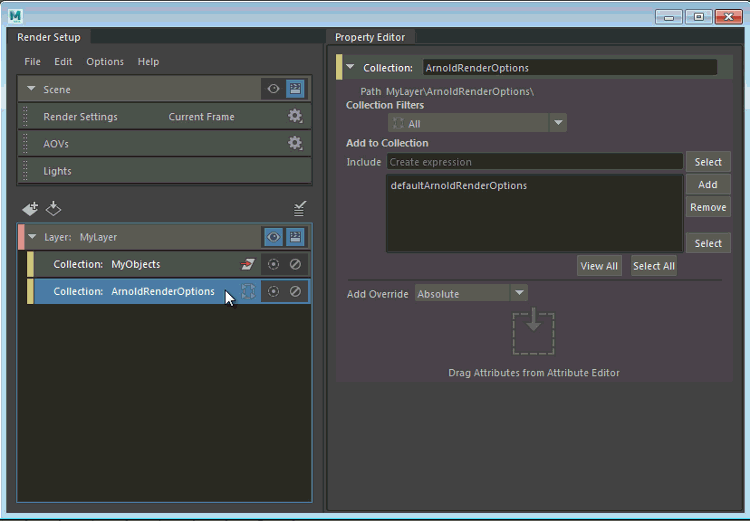

  1. Create a collection, and add to it the node(s) with the attribute or connection that you want to override.
    Ensure that your Collection Filters setting is correct and encompasses the node(s) that you want to override. Click View All to verify your collection membership.
  2. Right-click your collection and select one of: Create Absolute Override, Create Relative Override, and Create Connection Override.
  3. Select the override, and enter in Type Attribute the node and attribute that you want to override. Use the format node.attribute.

  1. Create a collection, and add to it the defaultArnoldRenderOptions node.
    Select All from the Collection Filters drop-down list to ensure that the node is not filtered out.
  2. Right-click the collection and select Create Connection Override.
  3. In the Property Editor, enter defaultArnoldRenderOptions.atmosphere and click Create.
    Leave the connection override unconnected to disable fog in your render layer.
