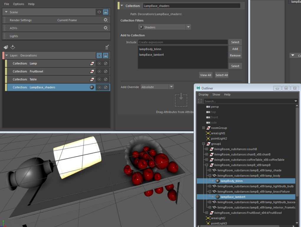

- Right-click the layer and select Create Collection to create a collection LampBase_shaders.
- In the Property Editor, select Shaders from the Collection Filters drop-down list to include shader nodes in this collection.
- In the
Outliner, ensure that
Display > Assigned Materials is enabled. Expand lamp_body and lamp_brass_Fixture in the
Outliner to display their materials. Select these two materials and click
Add in the
Property Editor to add them to the collection.

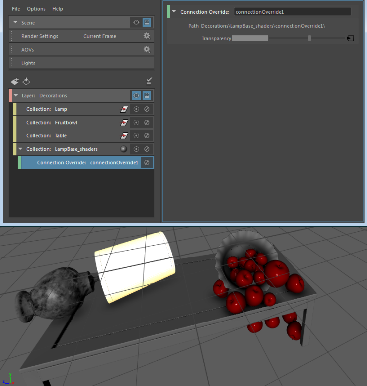

- Right-click the LampBase_shaders collection in the
Render Setup editor and select
Create Connection Override.
Drag and drop the Transparency attribute of any Maya shader from the Attribute Editor to the Property Editor, and map the override to any texture, for example, Fractal. The result is as follows.
Alternatively, you can enter transparency in the Type Attribute field of the Property Editor, and then map the override to a texture.
You can apply a connection override to more than one shader simultaneously. The override node searches for the specified attribute in all of the shaders in the collection. In this case, because both blinn and lambert have a Transparency attribute, the override is applied to the transparency of both shaders.
