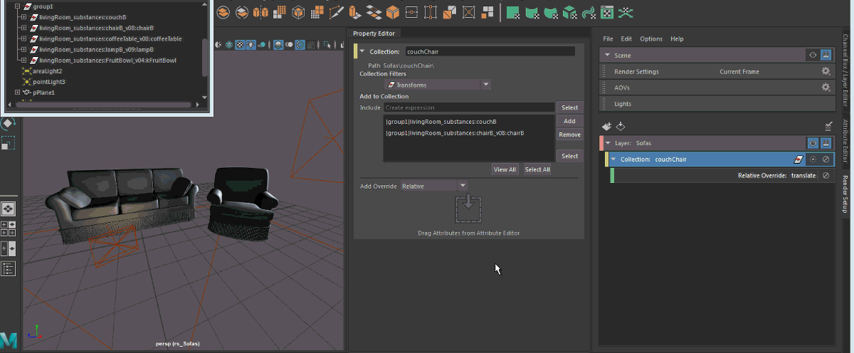

Note: If you had populated your collection by selecting parent node(s) and clicking Add, you should select the transform node of any of the parent nodes, not the child nodes. - Transform the objects in the viewport. The Property Editor for the override automatically updates to reflect the new values.

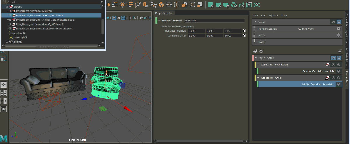

In this example, the couch and the chair are added to the collection by selecting their parent nodes and clicking Add.
The parent node of the chair is then selected and translated in the viewport. Both the couch and chair move as a result, and the translate override values update accordingly in the Property Editor.

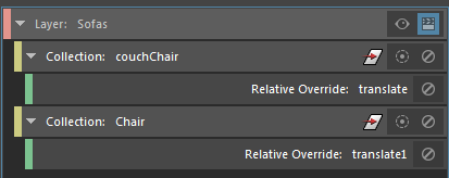

Overrides are applied top-down, as discussed in Create overrides for a collection by entering values in the Property Editor. When multiple overrides exist on the same attribute for the same objects, the override that appears furthest down in the list is the one with the highest priority.
In this example, a translate override is created for the collection containing a chair, and a translate override is also created for the collection that contains both the couch and the chair. If you select the chair and manipulate it in the viewport, it affects the translate override for the Chair collection, since it appears further down in the list and is therefore the one with the higher priority.
To affect the translate override for the couchChair collection instead, disable the higher priority override.
