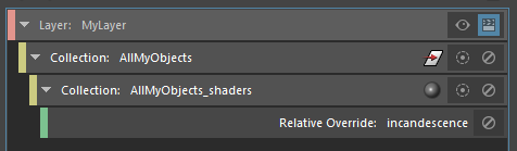

If you have a scene with 100 objects, each with a different shader applied, and you need to make each of the shaders 10% brighter, you can do as follows:
- Create a collection that contains these 100 objects.
- Select the collection, then select
Relative from the
Add Override drop-down list, and middle-mouse drag and drop the attribute Incandescence from any of the shaders
Attribute Editor to the
Property Editor.
A shaders subcollection is automatically created beneath your object collection, as well as a corresponding Incandescence override.
Select the override and adjust the Incandescence attribute in the Property Editor. All of the shaders included in your collection become brighter as a result.
This eliminates the need for you to adjust each shader individually.

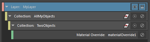

Example 3:
If you have a scene with 100 objects, each with the same shader applied, and you need to change the shading on two of these objects, do as follows:
- Right-click your layer and select Create Collection to create a collection that contains these 100 objects so that they are visible in your layer.
- Right-click your collection and select Create Collection to create a subcollection that contains the two objects for which you want to change the shading.
Right click this subcollection and select Create Material Override.
Select the override. In the Property Editor, click the
button to assign a different material; or drag and drop an existing material from the Hypershade to the Property Editor.
The viewport updates to show that only the two objects that are members of the second collection are assigned the new material.
In this case, because all the objects share the same shader, you cannot override an attribute on the shader as you did in Example 2. Otherwise, all the objects will have the same override applied. You should create a material override and not a shader override, since shader overrides are not collection specific, and are applied to all objects in the same layer that share the same initial shader assignment.
For more information regarding material and shader overrides, see Override the material applied to the objects in a collection.

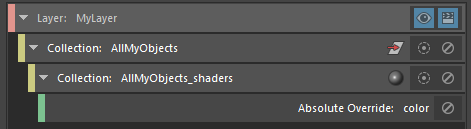

Example 5:
If you have 100 characters in your scene, and the characters are all wearing t-shirts that are assigned to different shaders, but you want to map all of these t-shirts to a new texture, you can do as follows:
- Right-click your layer and select Create Collection to create a collection that contains these 100 characters so that they are visible in your layer.
- Select the collection, and select Absolute from the Add Override drop-down list in the Property Editor.
- Select any of your shaders to display its
Attribute Editor, and middle-drag and drop the attribute
Color to the
Property Editor.
A shaders subcollection is created, as well as a corresponding color override.
Select the color override and click the
button in the Property Editor to connect to a new texture.
For more information, see Connect a network to an attribute using a value override.

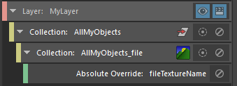

Example 6:
If you have 100 characters in your scene, and the characters are all wearing t-shirts mapped to one texture, but you want to map all of these t-shirts to a new texture, you can do as follows:
- Right-click your layer and select Create Collection to create a collection that contains these 100 characters.
- With your layer set to visible, select the collection, and select the file node from which you want to map to a new texture.
- In the file node
Attribute Editor, right-click the file path area of the
Image Name attribute and select
Create Absolute Override for Visible Layer.
A file node subcollection is created, as well as a corresponding file texture name override.
- Select the override. In the Property Editor, click the folder icon to connect to a new texture.
