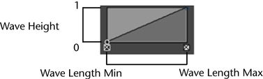

Wave Height
Controls the size of waves relative to their wave length.
The left edge of the graph represents waves with the shortest wavelengths and the right edge represents waves with the longest wavelengths (as determined by Wave Length Min and Wave Length Max).
If the value is 1.0, then the waves are half as tall as they are long.
If the graph is a horizontal line, then all waves will be exactly the same height proportional to their length. See Set fluid attribute ramps.

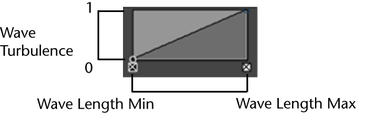

Wave Turbulence
Controls the amount of turbulence at different wave frequencies.
For values of 1.0 the wave motion will be completely turbulent at the defined frequency.
For each wave frequency, the turbulence wave component consists of multiple sine waves at that frequency. This is the most computationally expensive attribute. Making it zero will speed up renders significantly, although it is important for simulations of stormy or windy water. The Wave Peaking attribute only affects the turbulent wave layer, so there will be no affect from the Wave Peaking attribute wherever this value is zero.
For details on creating the curve, see Set fluid attribute ramps.
