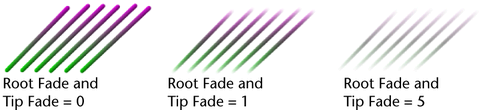

- Root Fade, Tip Fade
Makes the root end or the tip of the tubes transparent, in effect “fading” the root or tip. The transparency changes linearly between the center of the tube and the root or tip.
