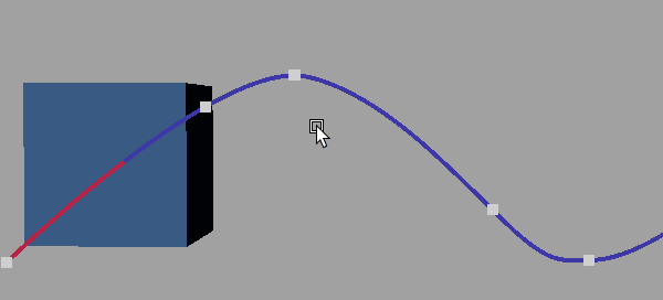

    Insert keys
    Right-click the Motion Trail and select Add/Remove Keys from the Marking menu. Click the place on the Motion Trail where you want to insert a key.

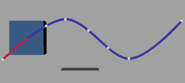

    Move keys
    Select a key, press w to activate the Move tool and slide the selected keys along the Motion Trail.

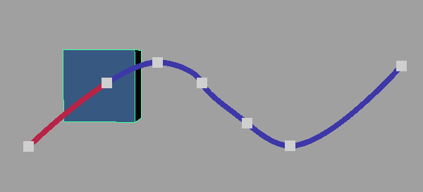

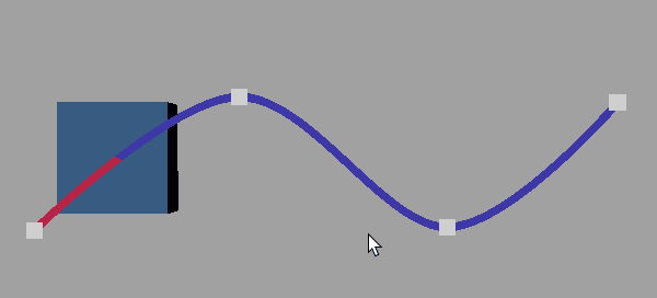

    Delete keys
    Right-click the Motion Trail and select Add/Remove Keys from the Marking menu. Shift + click a key on the Motion Trail to delete it.
    Click to add a key and Shift-click to remove a key from the Trail
