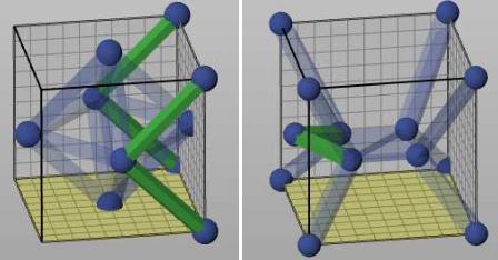

New elements for the transition are added in the same way new elements are added to a cell.
To move a transition
  1. Select the transition in the project tree.
  2. Right-click an element in the display.
  3. Choose Move into Transition and select the transition or <standard> to move into a the standard cell.
To rename a transition
  1. Right-click the transition in the project tree.
  2. Choose Rename Transition
  3. Enter a name for the transition.
  4. Click OK.
To remove a transition
  2. Choose Remove Transition to remove the transition from the cell.
To duplicate a transition
  2. Choose Duplicate Transition.
  3. Choose from the list of transitions to duplicate.
Duplicating transitions can be helpful when you have symmetric cells which require identical transitions in more than one direction, as you simply choose the direction of rotation for a duplicate and do not need to design the whole transition again.
