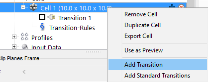

  1. Double-click the blue Plus icon next to the cell in the project tree.
    Tip: You can also right-click the cell and choose Add Transition.
  2. You can also right-click the cell and choose Add Standard Transitions to add six standard transitions (Back, Bottom, Front, Left, Right, and Top). The standard transitions are positioned in their respective directions.
When a transition is added, it is included into the project tree as subordinate element of the cell. When a transition is selected in the project tree, the normal bars, faces, and STL-elements of the cell are displayed transparently in the display. Similarly, when the cell itself is selected, the elements of all enabled transitions are displayed transparently.
