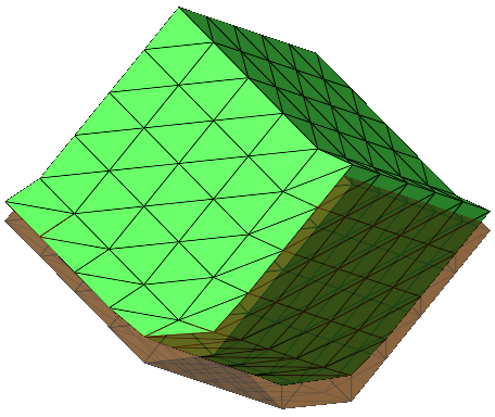

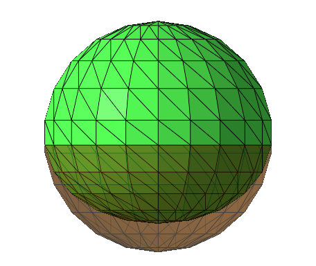

An exaggerated example of Z-compensation. The brown transparent section indicates the original shape.

- When you process objects with angled surfaces that terminate in sharp edges approaching the horizontal, these edges can get bent upwards. To mitigate this, try to avoid part orientations where sharp edges approach the horizontal, or try to avoid sharp edges entirely.
An exaggerated example of distorted edges. The brown transparent section indicates the shape before Z-compensation.
