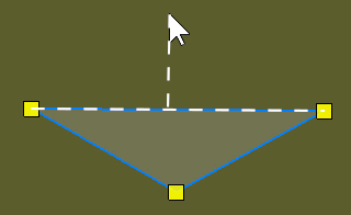

To create a cut with a free shape
- Click points on the display to set the corner points for the cutting stencil. As soon as you have set the third point, the stencil is created. (If you need a flat cut, use
plane cut with limited width instead.),
New points are always added above the perpendicularly nearest edge regardless of the order in which corner points were placed.
- Optional: To snap an edge to a multiple of 90°, hold Alt, then click on the edge near the point that should be moved.

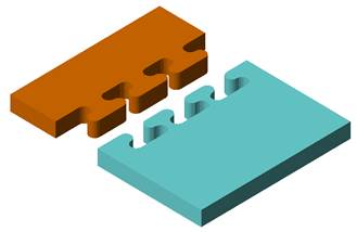

To configure a polygon cut edge
The edges of polygon cuts can be configured to create dovetail, jagged, or puzzle-shaped edges.
- Create the free-cut stencil first.
- To configure
all edges at once, click
Edit edge in the context view.
To configure only specific edges, right-click the edge and choose
Edit edge
- In the opening dialog, configure variant and shape.
- Click Apply to preview and produce the edited edge, and click OK to accept the settings and close the dialog.
A cut with puzzle pins
