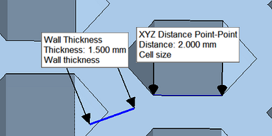

![]() Set wall thickness and cell size to adjust the grid pattern to your needs. |
| Wall thickness |
Adds a spacing between the cells. |

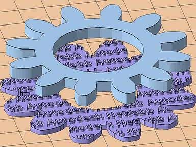

![]() A spur gear with a baseplate stenciled from a custom mesh |
