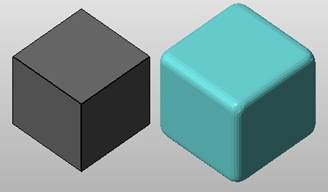

    Inner offset (right) of a box
    Outer offset (right) of a box
