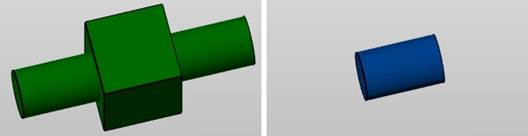

To unify parts
- Select the parts you wish to perform the Boolean operation on.
- Click
Boolean Operations
- Click
Unify Green Parts to unify the parts into a single part.
- Click
Apply Calculations to approve the operation.
To create intersection of parts
- Click .
- Click
Create Intersection of All Parts to create a new part defined by the overlapping regions of the selected parts.
- Click

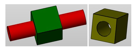

To subtract parts
- Click .
- Initially, all selected parts are listed in the green parts container. Click a part in the display to move it to the list of parts in the red container. The part(s) listed in the red container will be subtracted from the green parts.
Tip: You can also select the name of the part in the list and use the arrow buttons to move the part into the red container. Click a part a second time to move it back to the green parts container.
- Click
Subtract Red Parts from Green Parts to subtract the parts.
- Click
