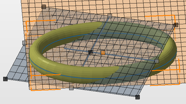

  1. Move the clip planes so that at least one of them intersects with the parts to cut. There are multiple ways to specify the clip plane position:
    • Move the sliders.
    • Enter a numerical value into the input fields. The numbers set here are absolute and refer to the whole buildroom.
    • Right-click the slider of the desired axis, choose Set plane in X, Y, or Z, depending on the clicked slider, and then click on the part to set that plane to the clicked position.
  2. Optional: In the context view, set the dropdown selection to Cut all parts or Cut only selected parts to match narrow or widen which parts to cut.
  3. Enter the cutting snapin by clicking the Plane cut button in the context area, or choosing Modify > Cut > Plane cut from the main menu.
Placement modes
  1. Enter cutting by clicking the Plane cut button in the context area, or choosing Modify > Cut > Plane cut from the main menu.
  2. Create cutting plane by 3 points: Click on three positions on a mesh surface through which the plane should go.
    Tip: The cutting plane is generated when you release the mouse click from placing the final point. To see a preview of the plane, keep the mouse button held down for the last point. The center of the plane is placed at the same location as the final point.
  3. Create cutting plane tangential to surface: Click on a single location on a mesh surface. This places the cutting plane flatly onto the location (the triangle) that you clicked.
  4. Create cutting plane vertical to surface: Click on a single location on a mesh surface. This places the cutting plane vertically onto the location (the triangle) that you clicked.
    Note: The initial orientation of the plane around the vertical (the normal) of the selected triangle is dependent on your current camera orientation. You can still adjust it further.
Top
Optional: Adjust at what angle and how wide to cut
If the plane is already in the right position, you can proceed to cutting. If not, adjust the plane using any of these methods:
Rotation and size
  • Optional: Using left-click, drag the corner points of the plane to rotate the plane about its normal axis. This adjusts the plane's rotation axis for the next step:
  • Using left-click, drag the edge points to rotate the whole plane about the axis tangential to the edge point.
  • Using right-click, drag the edge and corner points to resize the plane. Useful if you want to cut only a section of a part while leaving the rest alone.
The cutting plane cuts at any angle you require.

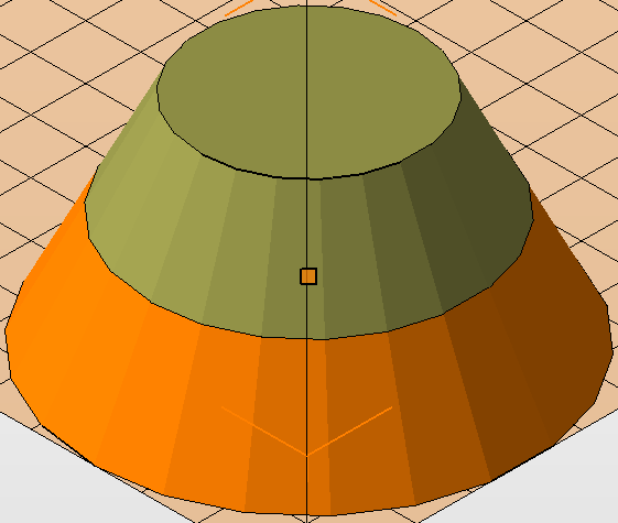

Perform the cut
In the context view, click Cut.
This cone frustum has been cut in half.
