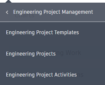

The Engineering Project Management template includes the three workspaces grouped under the Engineering Project Management category.
workspaces
The Administrator can adjust the order and location of these workspaces in the main menu.
