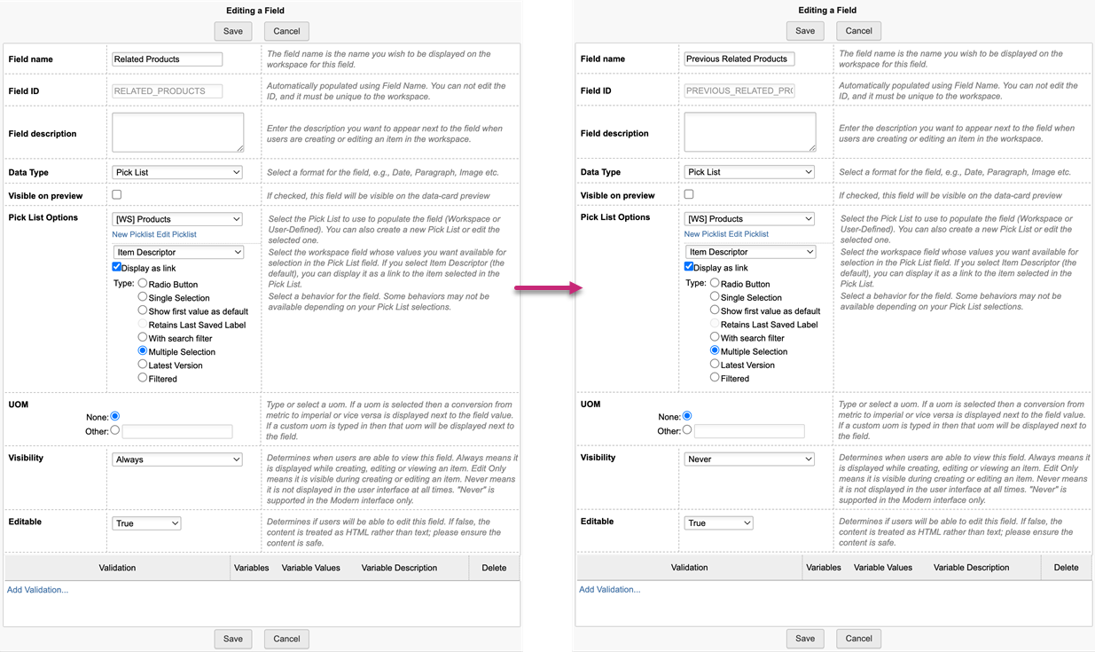

Next, return to the Details tab of the Ideas worskpace in the Workspace Manager. For each reference workspace of interest, clone the referring field to enable storage of previous values. This is required for the edit script to detect changes to the referring items. For example, clone the field Related Products as Previous Related Products:
workspace manager
Set the cloned field to be invisible (Visibility = Never). Do not change the field definition itself (it should still be of type picklist). Prepend the prefix ‘Previous’ to the field’s name as shown in the illustration.

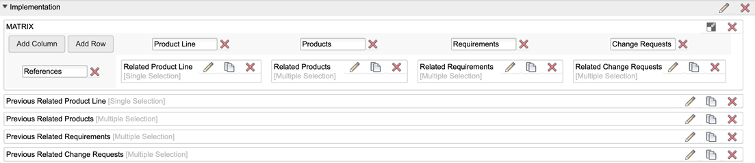

When finished, there should be a clone with prefix ‘Previous’ for each relevant reference field:

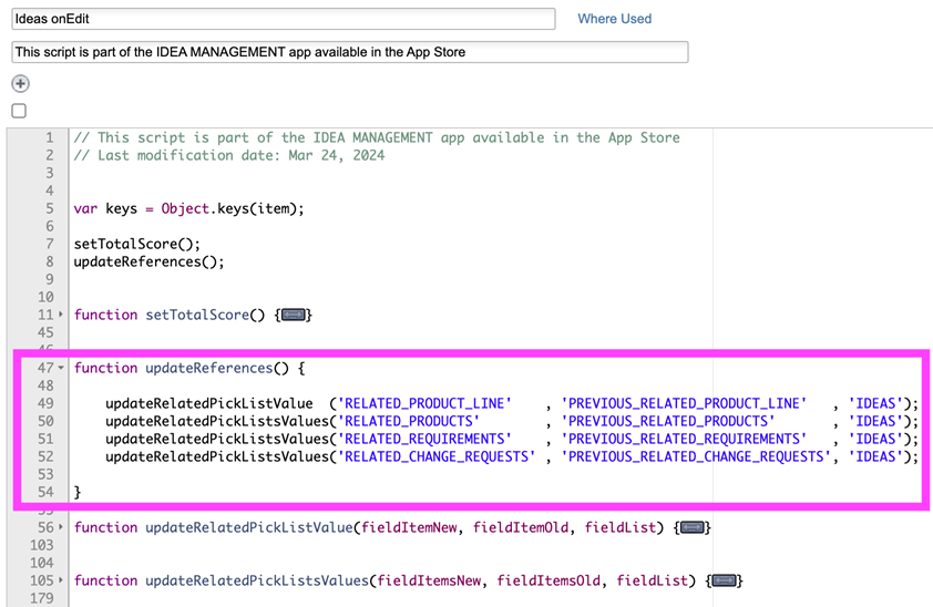

You can see in script Ideas onEdit how these fields are used to update the related single or multi picklist fields IDEAS in the related workspaces. If you add more reference fields, you will have to adjust this script accordingly.
