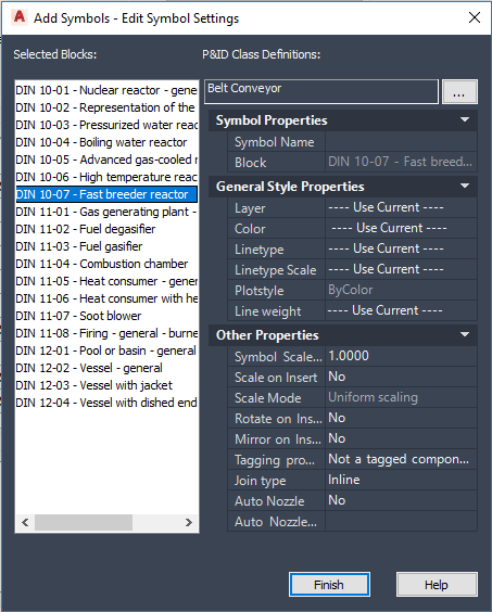

Displays a list of blocks that you can assign to class definitions. Once a block is assigned and its properties set, it becomes the symbol for that class definition.
Selected Blocks
Displays the blocks you want to assign.
P&ID Class Definitions
Displays the P&ID class definition to which you want to assign the selected block. You can use the [...] button to locate and select the class definition you want.
Symbol Properties
Lists the name of the symbol and block used to control the geometry that is displayed for a component after it is inserted into a drawing.
Note: Depending on the class you select, Symbol Properties change to reflect the default values for the selected class.
For details, see Symbol Properties.
General Style Properties
Lists the general properties that are assigned to a component when it is inserted into a drawing. For details, see General Style Properties.
Other Properties
Lists other properties that are assigned to a component when it is inserted into a drawing. For details, see Other Properties.
