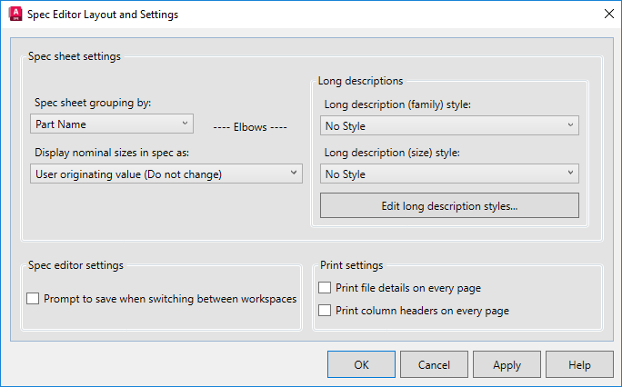

Spec Editor Layout and Settings Dialog Box
Sets preferences for the Spec Editor workspace layout.
List of Options
The following options are available in this dialog box.
Spec sheet grouping by
Groups items in the spec sheet by part category (for example: Fittings), part name, or both.
Display nominal sizes in spec as
Displays units in the spec sheet in imperial units, metric units, or unconverted (native).
Long Description (Family) style
Sets the style for the Long Description (Family) property of the current spec sheet.
Lists long description styles that were saved to the default location: C:\AutoCAD Plant 3D 2026 Content\\LDStyles.
Long Description (Size) style
Sets the style for the Long Description (Size) property of the current spec sheet.
Edit long description styles
Opens the Edit Long Description Style dialog box where you can specify the description formula.
Prompt to save when switching between workspaces
When selected, prompts you to save any files that have been modified when switching to a different workspace.
Print file details on every page
When selected, details such as the spec description, file name, and file date are added to the top of each page. When clear, file details appear only on the first page.
Print column headers on every page
When selected, the column name appears at the top of every page.
