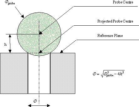

The following example shows how PowerInspect calculates the point:
If the reference plane is further from the probe centre than the probe radius (h > ), PowerInspect cannot calculate the diameter of the circle, and its nominal is not updated.
