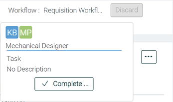

A task or decision created by a CN workflow may be completed in a number of ways:
On the CN, below the workflow name, hover your cursor over the action bar. This loads a window with the button to complete the task.
On the CN dashboard, single click the CN to load its details pane on the right. At the top of this window is the button to click to complete the task.
Expand the list of current tasks below the CN. Click the task to load its details pane on the right. At the top of this window is the button to click to complete the task.
Once you click the button, the workflow proceeds until it is complete or it moves onto the next task.
