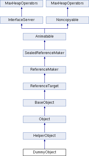

This class represents a dummy helper object. There are several methods plug-ins may call to get and set the size, and set the color of the dummy object. These are used when a plug-in needs to create a dummy object in the scene. This class provides implementations of all the required methods of Animatable, ReferenceMaker, ReferenceTarget, BaseObject, Object, and GeomObject. All methods of this class are implemented by the system.
+ Inheritance diagram for DummyObject:
