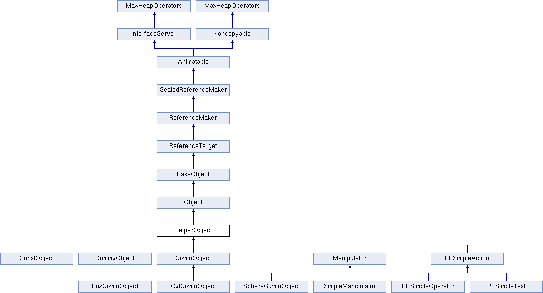

This is used as a base class to create helper object plug-ins.
It simply provides implementations for a few of the methods of Animatable and Object.
Inheritance diagram for HelperObject:Public Member Functions | |

inlinevirtual |
Implemented by the System.
Returns the super class ID of this plug-in type: HELPER_CLASS_ID
Reimplemented from ReferenceTarget.
inlinevirtual |
Returns 0 to indicate this object type may not be rendered.
Implements Object.
Sets the default node name to "Helper".
Implements Object.
Reimplemented in SimpleManipulator, BoxGizmoObject, CylGizmoObject, DummyObject, PFSimpleAction, GizmoObject, and SphereGizmoObject.
inlinevirtual |
Returns TRUE to indicate the object color is used for display.
Reimplemented from Object.
Objects that don't support the IntersectRay() method (such as helper objects) can implement this method to provide a default vector for use with the normal align command in 3ds Max.
| t | The time to compute the normal align vector. |
| pt | The point of intersection. |
| norm | The normal at the point of intersection. |
Reimplemented in ConstObject.
