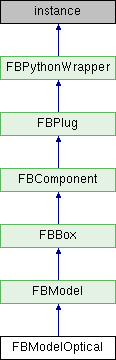

Optical model class.
Inheritance diagram for FBModelOptical:Public Member Functions | |
