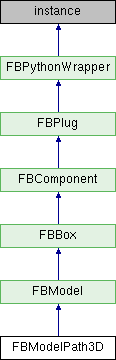

Path 3D model class.
Inheritance diagram for FBModelPath3D:Public Member Functions | |
